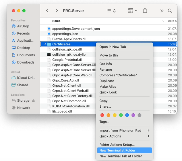

Semi-Automated Installation: macOS
In the PRC.GH folder, open the Certificates subfolder in a Terminal in that folder and enter the following command to install the certificate.
Image without caption
bash
security add-trusted-cert -r trustRoot -k ~/Library/Keychains/login.keychain-db ./PRCRootCertificate.crt
The same command is also available by double-clicking the CertificateInstaller_macOS.command file in the Certificates directory in the PRC.Server directory. However, your mac may prevent you from executing that command. You can simply open a Terminal window and enter bash CertificateInstaller_macOS.command

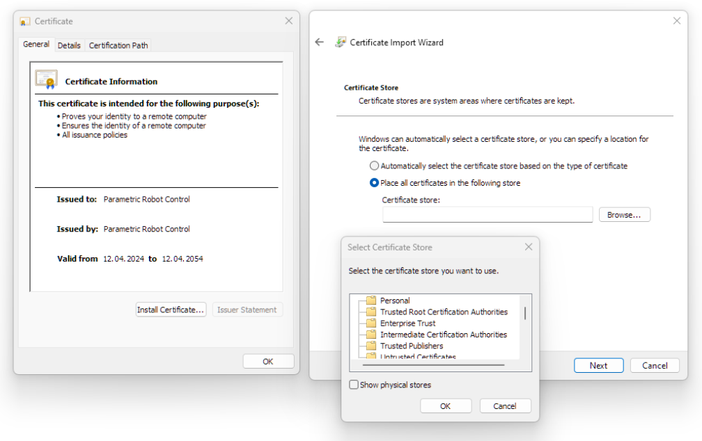

Go into the %LOCALAPPDATA%\Parametric Robot Control\PRC.Server\Certificates folder. Double-click the PRCRootCertificate.crt file, select "Install Certificate" for "Current User". Then select "Place all certificates in the following store" and choose "Trusted Root Certification Authorities".

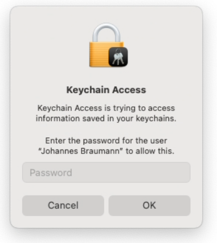

Navigate into the Certificates folder within the PRC.Server directory. In order to access your keychain, you will need to enter your password.

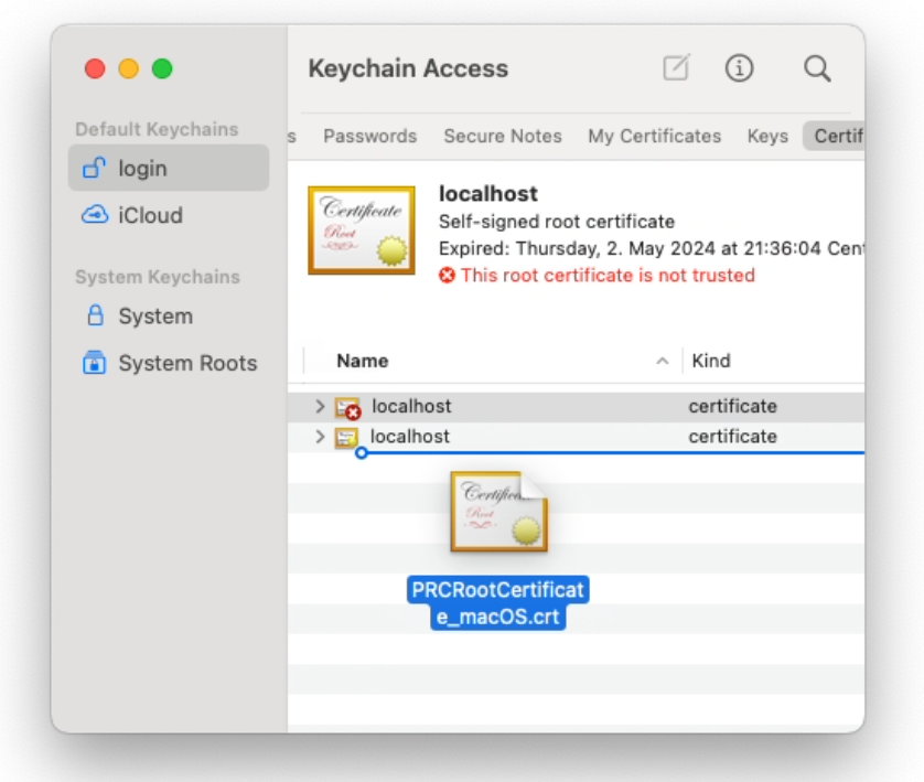

Drag and drop the PRCRootCertifcate_macOS.crt into the Certificate section of the login Keychain.

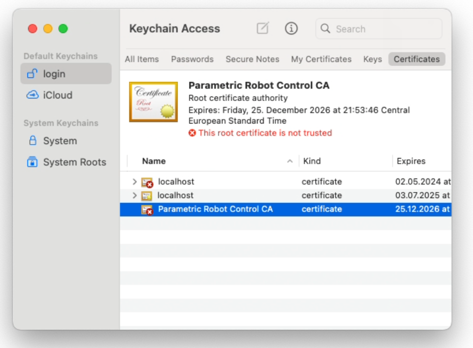

The certificate will show up with a red warning.

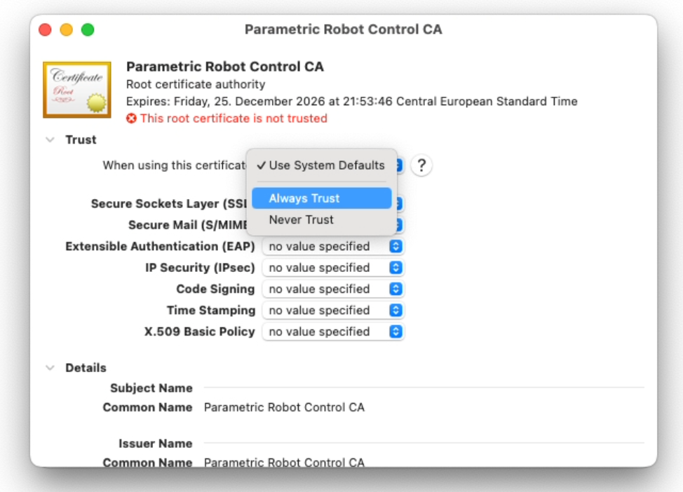

Double-click it and open the Trust option. Select โ€œAlways Trustโ€.

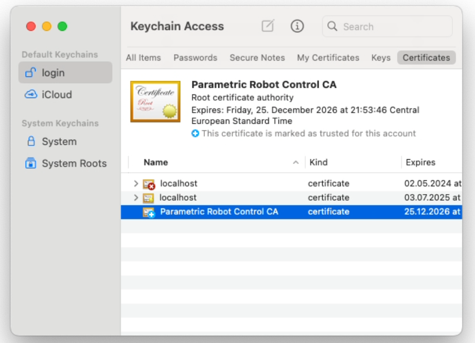

When you exit the window, you will need to enter your password again. If succesful, the certificate will have a blue mark. As macOS requires us to update certificates frequently, you may have to repeat the process every few updates.
