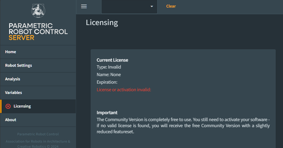

Please follow these steps to acquire your license. When you open the server user interface (by default: https://localhost:5001) the software will complain about a missing license.

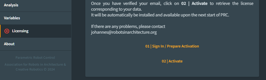

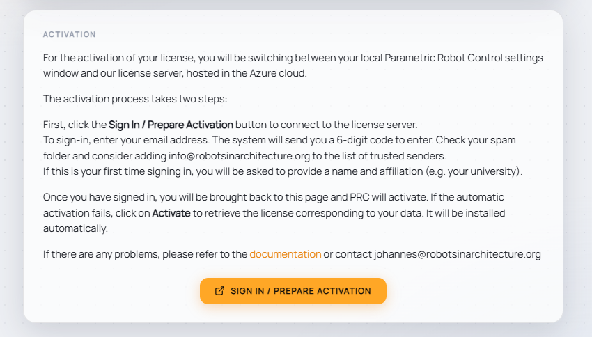

Scroll down and click on "01 | Sign-in / Prepare Activation

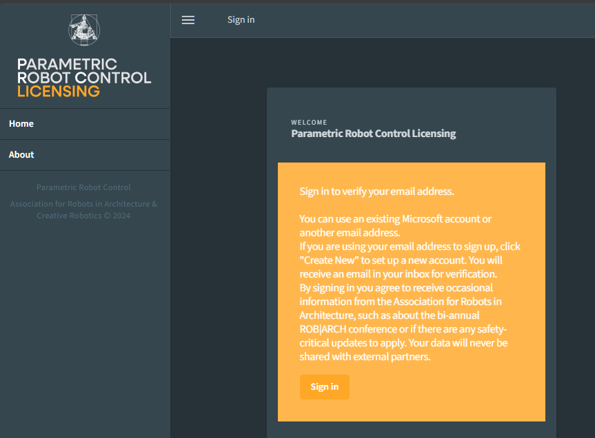

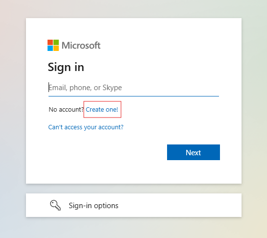

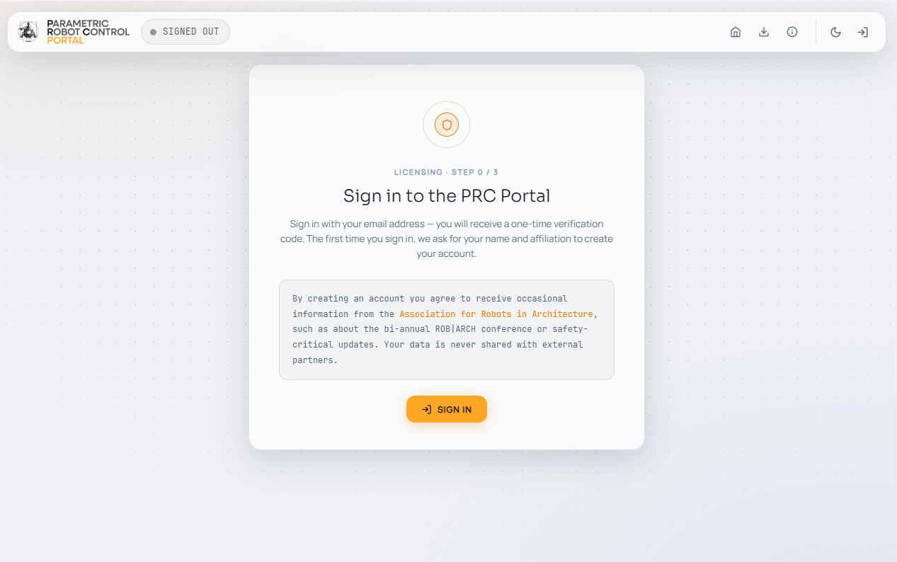

You are now forwarded to the PRC License Server, hosted on Azure. Click "Sign in" to proceed.
Image without caption

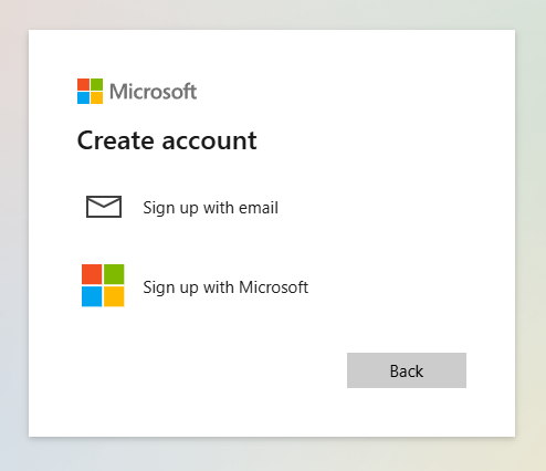

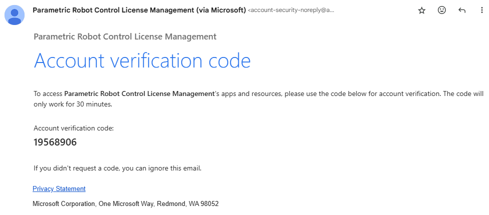

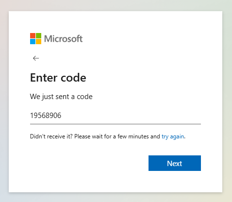

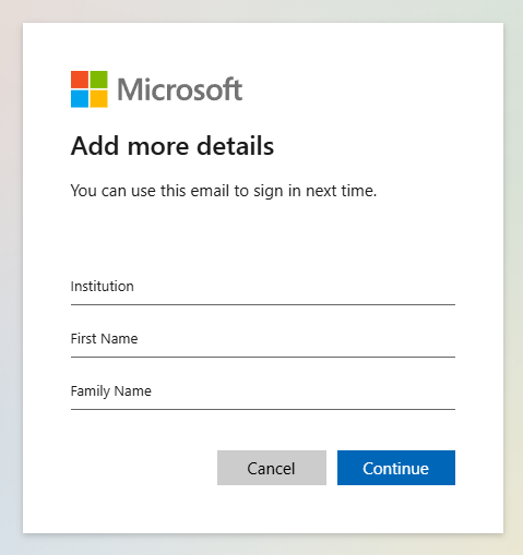

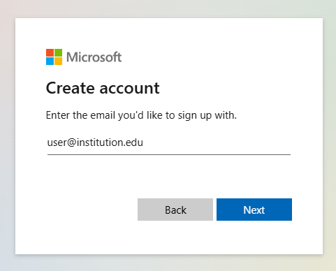

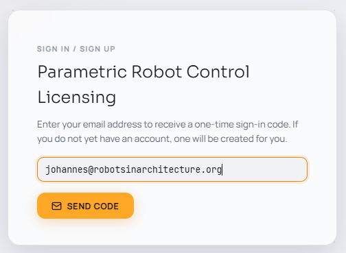

You will have to enter your email address to proceed. If this is your first time signing up, the system will ask you for your name and affiliation. You will then be sent a one-time password consisting of 6 digits. Enter it.

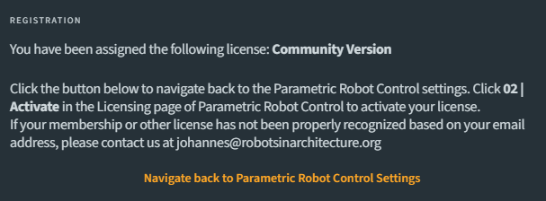

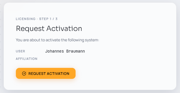

You will then be informed about the license that has been assigned to you. Contact johannes@robotsinarchitecture.org if there are any issues. Click the button to go back to the PRC Settings.

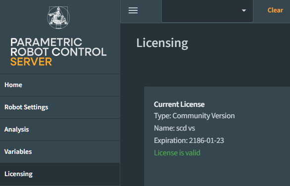

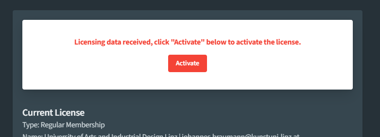

Click "Activate" to activate your license.

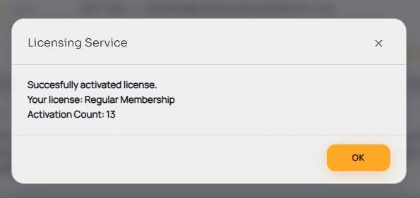

You will be notified that your license has been applied. The red error sign next to "Licensing" will disappear once you navigate through the UI.
If you have got a membership or commercial license, the license should extend itself as long as your membership/license is active.
