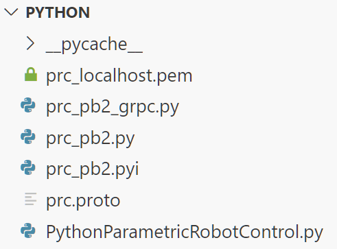

This gets you the following three files:
prc_pb2_grpc.py
prc_pb2.py
prc_pb2.pyi
Along in the folder is the prc_localhost.pem certificate for the SSL encryption. It is included in the example project.

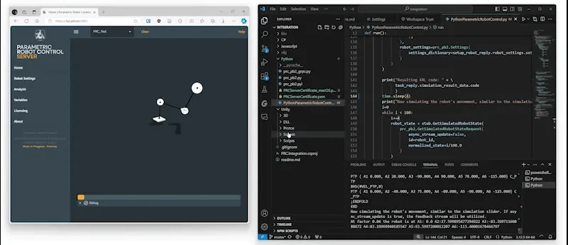

You can go through the simulation through the GetStimulatedRobotState call. In the example below, it iterates by 4% every 400ms.
python
i=0 while i < 100: i+=4 robot_state = stub.GetSimulatedRobotState( prc_pb2.GetSimulatedRobotStateRequest( stream_update=False, id=robot_id, normalized_state=i/100.0 ) ) axis_values = robot_state.actual_axis_position.axis_values print("At factor " + str(i/100.0) + " the robot is at A1: " + str(axis_values[0]) + " A2:" + str(axis_values[1]) + " A3:" + str(axis_values[2]) + " A4:" + str(axis_values[3]) + " A5:" + str(axis_values[4]) + " A6:" + str(axis_values[5]) ) time.sleep(0.4)
