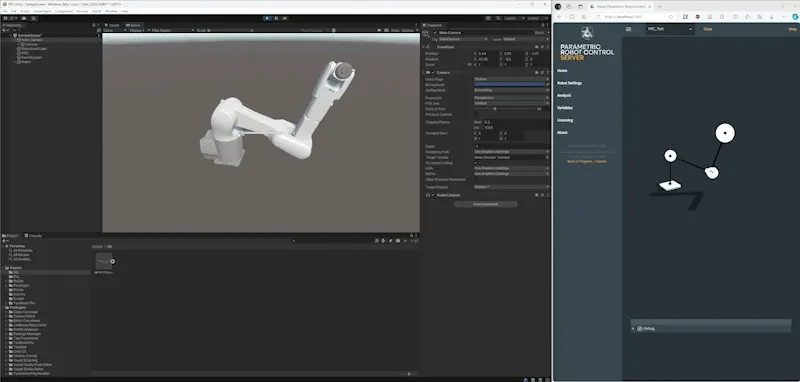

Unity by default works with meters as units and Y+ up. PRC internally works with mm and Z+ up. You may need to multiply your Unity coordinates by 1000 and switch Y and Z.
It is convenient to pack the data from the protobuf definition into a separate dll. We created a NetStandard 2.1 project in Visual Studio with references to the Google.Protobuf, Grpc.Core and Grpc.Tools packages, added the *.proto files set the build action to Protobuf compiler / Client only in the properties. This created a PRC.Protos.dll that is imported into Unity.

For visualization, the PRC_Unity.cs file has to transform the matrices from the CAD-centric right-handed, Z-up coordinate system into Unity’s left-handed, Y-Up coordinate system.
