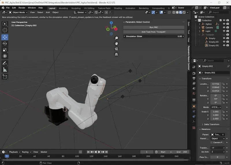

The PRC_AgilusTest.blend file contains the robot geometry (without requiring rigging or an armature).
Pack the content of the folder into a ZIP file and import it into Blender via Edit > Preferences > Add-ons > Install.

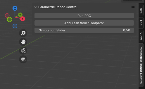

It should now be visible in the sidebar.
“Run PRC” starts the server, use that one first. It comes with a standard movement that you can then simulate via the “Simulation Slider”.
The “Add Task from ‘Toolpath’” button takes the transformations from all objects in the Toolpath group and uses them as Cartesian targets.
Note that the code applies the relevant transformation and also scales everything by a factor 1000 as Blender works better with small units (meters) while the robot expects millimeters.
